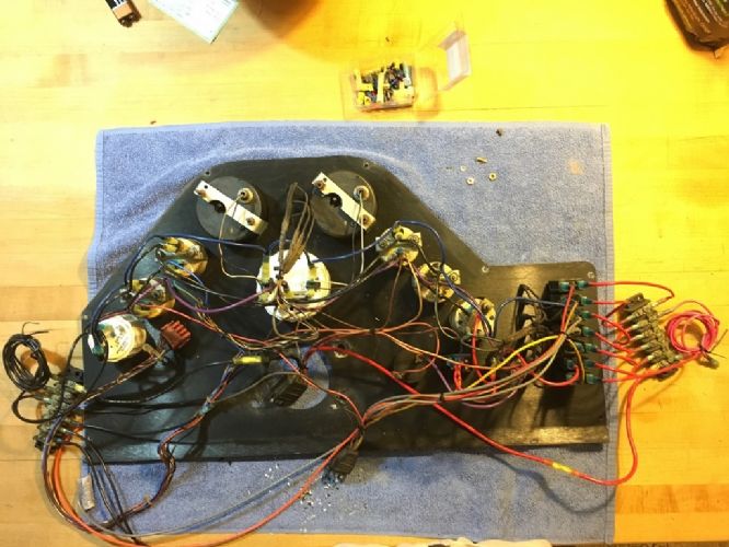

I've been reading up on a dash rewire, but as I've never seen the dash and wire loom as it was installed it gets a bit confusing. I'm a bit lost if I should up the wire size for all wires in the instrument cluster or only the ones leading from the battery to the daisy chain. reading a lot about adding extra power and negative wire to the wire loom, just not really sure where to? Anyways, I'm guessing that a lot of things will become clearer when we start working on it.

I'm assuming you pulled the instrument cluster out of the dash.  Put up a picture of the back of your instrument cluster.  I rebuilt my 86 nautique cluster wiring and i've got pictures.  If it looks the same, I can send you what mine looked like finished and some info on how I went about it.

Hi Andrew,
Many thanks in advance.
As far as I know, the dash wiring should (mostly) be the same between the SN & the BFN.
We bought the boat already disassembled , which is what makes some parts a bit more complicated. herewith the view of the dash/cluster (VDO gauges) as it is:

Wow, that's in pieces.  Front of your dash looks like mine, so they should be pretty close or the same.
First picture is the back of the dash before I rewired it.  Note there are some repaired wires on the before picture, done when I was replacing the RPM gauge, anything I repaired has marine grade heat shrink terminal connectors.  Most of the old connectors are dark blue.
Second picture is after it's rewired.  The coiled up wires next to the two terminal blocks will connect to the old power wires under the bow.  I added watertight terminals that I can disconnect to the ends so I can pull the dash without cutting anything if I need to pull it again.  I have to stick my head up under the bow and check where I landed them but I think I ran an additional ground from the engine and a power wire from the solenoid to the dash because the wires supplying power and ground that are part of the old system are too small gauge wise. Good ratchet crimpers are a must for doing this neatly, just FYI.
I can get some pictures of the back of the rewired dash installed if needed.  Boat is currently under my back deck at the tail end of stringer replacement.  Let me know.

Resolution looks better on my computer than it is after I uploaded the pictures.  PM me and I can email you the pictures, might be able to follow the wiring better.

Thank you all for your input. We started the rewire and in the end it isn't as intimidating as it seemed.
We just needed a little nudge to start and i'm guessing we'll be done by the end of this week.
I'll double check our work with Andrews picture to make sure we dind't make any mistakes.

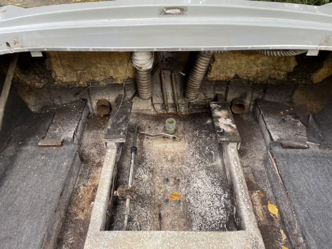

In the meantime I found some more parts that I do not recognise.
Anyone knows if these are original parts and if so, what are they used for?
It's not clear from the picture but the 2 washers (on the bolts, left) have a step. the inner part is thicker than the outer part.

it's the bolt that holds the rudder cable clamp to the stringer.  on my 86 sliver nautique it was installed 24" from the stern.  Drill a hole about half way up the primary stringer through to the space where the muffler sits and bolt in place.  the ball sticks into the bilge side and the rudder cable clamp attaches to the ball.  there is some play in the ball allowing the clamp to move around while still holding the cable in place.
In the picture the clamp is that grease covered things around the cable, cleaned up pretty good to a nice white.  This is a before picture, things are much better looking now but the boats at the marine shop waiting to have the engine dropped in.

I'm guessing that means it should have been installed before we foamed and glassed over the empty space between the stringer and the floor...Cool

Looking over your pictures, I think you're ok.  What I'm calling the primary stringer, where the bracket gets fastened, is that lower stringer in your pictures.  the one closest to the center of the boat.  The outboard taller one is the secondary stringer.  You don't fasten to the secondary.
You have to get slightly creative.  Instead of bolting into the side of your low primary stringer, you would make a small stainless bracket with a hole in the vertical leg for that bolt with the ball on the end and two holes in the horizontal leg.  Lag the new stainless bracket down to the top of your primary stringer through the horizontal leg  and hook the "ball bolt" to the vertical leg with a nut on each side of the bracket.  Should get the job done.
I suppose you could fiberglass the stainless bracket down to the stringer so you don't put holes in your stringer for the lags.  Or you could fiberglass in a hump into your low stringer and drill hole in it and put the bolt through as originally installed.  Lots of ways to slice this melon!

I was thinking something alike, fabricate a stainless plate and weld a shortened bolt to it. and attach it to the stringer. I'm just curious how much force is on the rudder cable when turning under high load/speed.
The original bolt size seems to suggest its quite a lot, however, i'm thinking it's a bit overkill?

Here's a picture from TRB's BFN rebuild thread
A hunk of angle aluminum or stainless steel bolted to the strut mounting bolts with the clamp block bolted it.
Lots of boats were built with that setup.
Fairly close to indestructible mounting and easy too   Wink
