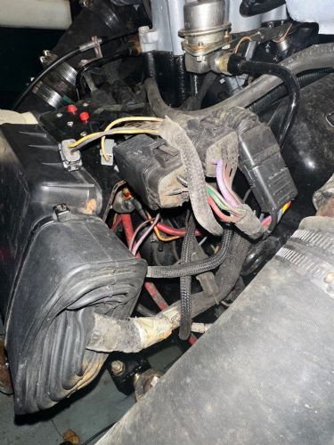

Thanks for the intel Keno. I appears that once I can move the ECU mount out of the way I'll have reasonable access. How much slack in the harness will determine how much room I have to work with. Here are the pics of my ECU install...

Probably worth mentioning, for anybody saying something like "my ECM, breakers and relays aren't mounted like that" that your pictures are of a gt40 in a Hydrodyne

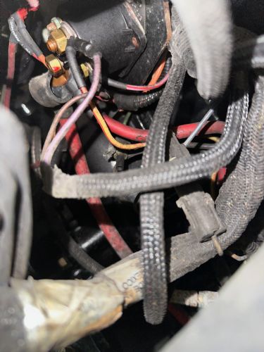

Not difficult, but time consuming because of access. The angle plate gets unbolted, then the CB's get taken off so you can gain better access to unbolt the relay FROM the interior of the plate, so you can swap it out. Then it's plug and play.
With that said, I KNOW I did NOT disconnect this beast, coming from the main harness, starboard side, and the corrosion and dirt on the press fit would indicate it's been sitting around. Test port for the Rotunda? Haven't pulled up the diag. yet. Thanks, Mark ![]() |
