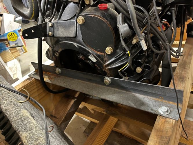

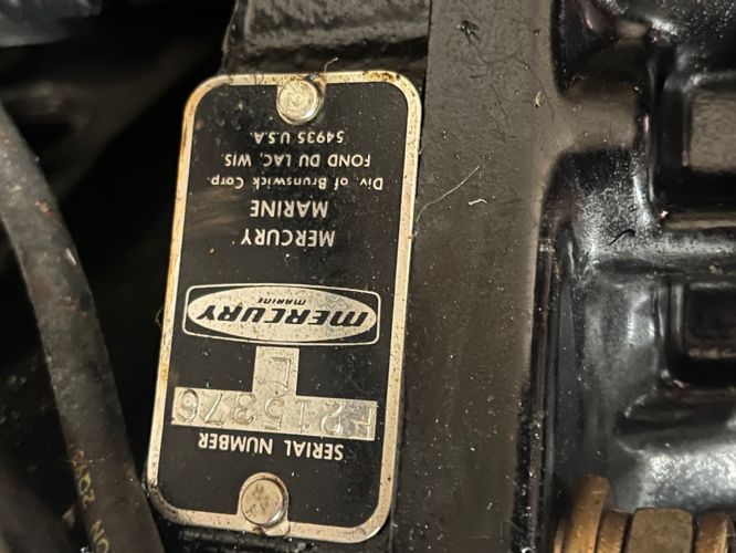

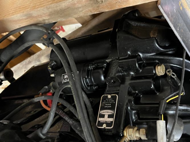

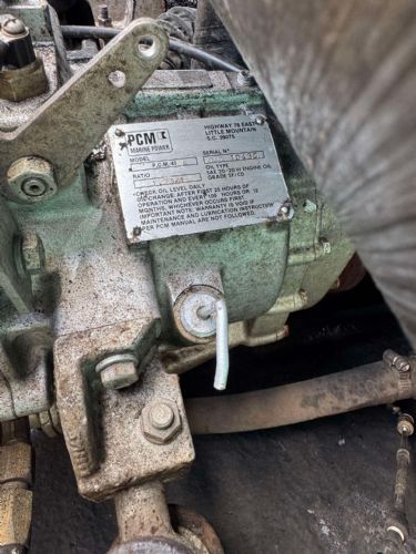

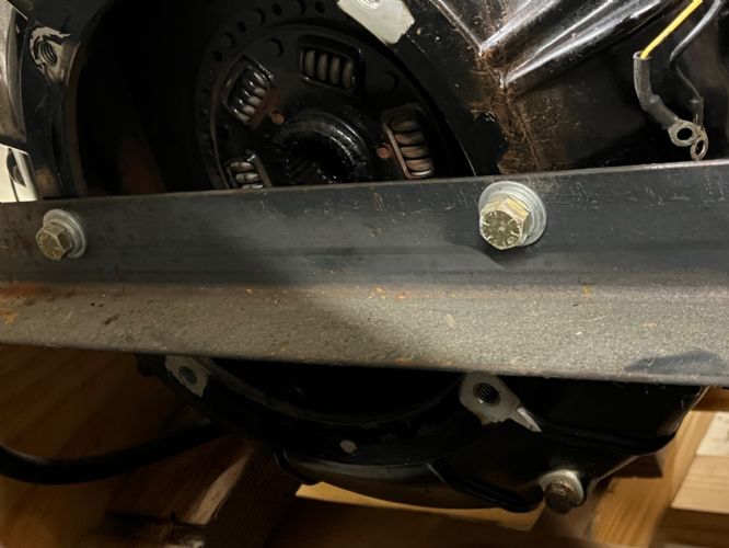

Now if you had said a few more things in your first post, this would have been a whole lot easier. Wink
Looks to me like you have the Mercruiser engine, complete with it's starter  and flywheel and bellhousing.
So....you don't have to look for much of anything to mate the PCM 40A to the Mercruiser bellhousing.
The bolt pattern on the Mercruiser bellhousing and the PCM bellhousing on you Ford are the same on the flange that the transmission bolts to.
Just so you understand.....You don't need a new bellhousing.
You do need to take the bellhousing off of both engines and take the damper plate off of the Ford and install it on the Chevy flywheel. It'll bolt on.  You don't even have to remove the flywheel.
If you want to reuse the used PCM  damper plate or buy a new one, that's up to you.
Then you put the Mercruiser bellhousing back on the Chevy.
And then......you install the PCM 40A on the bellhousing.
You may have to mix and match mounting bolts and studs from the PCM bellhousing and the Mercruiser bellhousing
Now you have an engine and transmission all hooked to each other, ready to install into the boat.
What you do with engine mounts already got mentioned
You'll have to figure your exhaust setup to go from the 2 Mercruiser exhaust manifolds to one 4 inch outlet at the transom
You'll also have to go from 1 inch ID hose at the hull intake to 1 1/4 inch hose before you get to the raw water pump. Probably easiest to go 1 inch to the transmission cooler and then after the cooler outlet use a 1 to 1 1/4 barbed fitting to have 1 1/4 inch hose to the raw water pump.
Mounting the bracket for the shift linkage may be straightforward or may take a little creativity.
If you have them both out of the boat and do the work, it'll be easier mating them together and then put the engine and transmission in the boat together.

Here are pictures of the Mercruiser going in and the existing transmission in the boat.  What do I need to marry these or will they bolt together as is?  Thank you!
