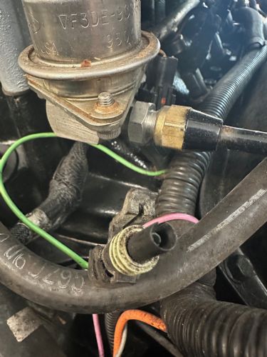

Not difficult, but time consuming because of access. The angle plate gets unbolted, then the CB's get taken off so you can gain better access to unbolt the relay FROM the interior of the plate, so you can swap it out. Then it's plug and play.
With that said, I KNOW I did NOT disconnect this beast, coming from the main harness, starboard side, and the corrosion and dirt on the press fit would indicate it's been sitting around. Test port for the Rotunda? Haven't pulled up the diag. yet. Thanks, Mark ![]() |
